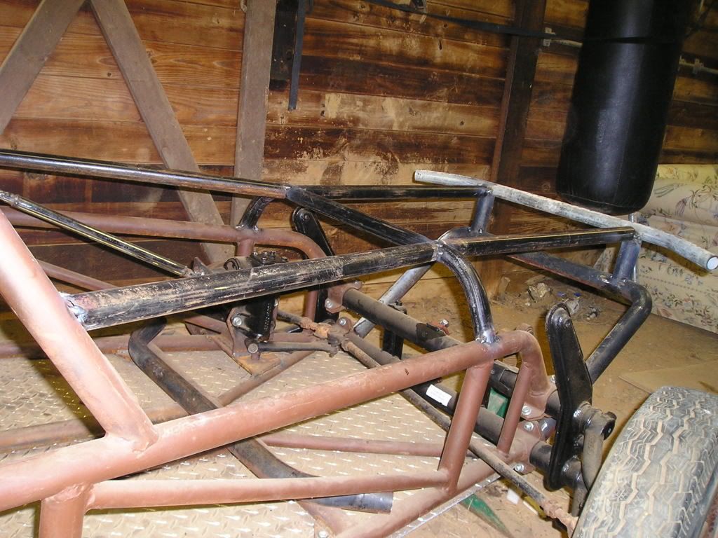

new to the buggy world so any help would be great

Looks like you got a good start. You need to add the front race brace, a set of tree bars and don't forget the X bracing behind the seats. Also I would suggest a second set of roof bars on the outside edges of the roof line. Look for some of my photos, you'll see what I mean.

thanxs and im still working on the bracing i spent close to 4 1/2 to 5 hours making the front bumper alone today lol
the hand pipe bender is realyyyyyyyyyyyyyyyy slow but it gets the job done

heres some more pics i think theyll be a bit bigger the reason for the small pics is that i took them with my phone these are from my camrea so they should be better
bet you cant guse what kind of steering this is lol jk :D
its from a suzki sameri that i built for a guy i put full size blazer axles under it frount and rear with hydralic stearing so i had it laying around and the fact its coming out of a 4wd i think it ought to hold up better than that dinky vw stearing box
I HATE THIS THING ITS SO F*/@/# SLOW!!!! ITS THE DEVAL :twisted:

Looks great! I did notice however you are going to have one hell of a time unbolting your bumper, seeing as the top is welded directly into the frame, correct me if im wrong. Might want to weld flanges on to the end of the tubes and bolt it up top as well.

i know it is solid on the top to mount points and yes the bottom two are solid to the botom clamps but heres a pic of what i was going to do on the top mounting points b.c i dont want to have flanges i hate the way they look and i think this idea is going to be alot stronger than the flange
tell me if you think otherwise b.c its only tacked together right now so changes can be made
the black is the main tube that you can see in the real pics right now
the red is the inside od tube of the black one
the green is bolts
what my plan to do was cut the black and insert the red pipe and drill 4 holes to bolt it all together

I did something similiar to the front of my wife's buggy, I also hate bulky lookin flanges. I think it oughta work fine. Might be a bear if it gets bent to get it back together, like mine, but oh well. just have to cut it out and re-do it.
You are doing a nice job on that rail. Inspiring my 13 year old alot.
