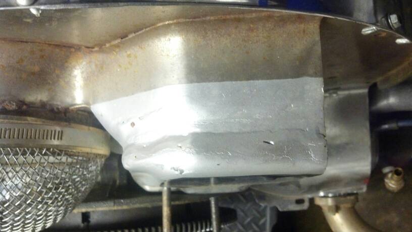

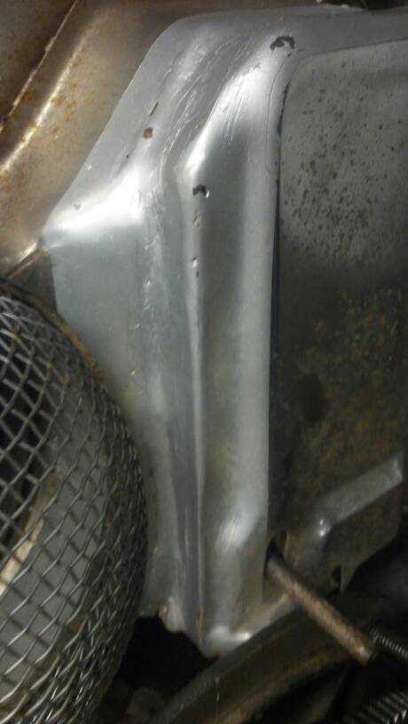

You can get a new one for $90 that.s all i use they work great .Just keep in mind you got to modify your tins i will post a pic a little later today what mine looks like.But Drews keeps them in stock i,m building a motor for a guy and just picked one up.

I don't know what I was thinking, I probably will just buy a brand new one, drrrr. But yes, Darrel post me some pictures. I know my cousin has one (he has Roy Dodds old buggy), but I haven't looked at it in a while. I pretty much just have to cut the dog house and weld in an extension to make up the width difference between a type 1 and type 4, correct? My cooler sits over my cargo rack, so therefore I have no room for the damn beer cooler, and they just get ruined on the treebar!

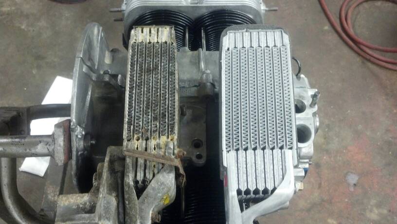

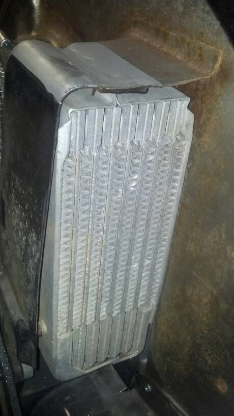

PostPosted: Wed Jan 01, 2014 9:13 pm
