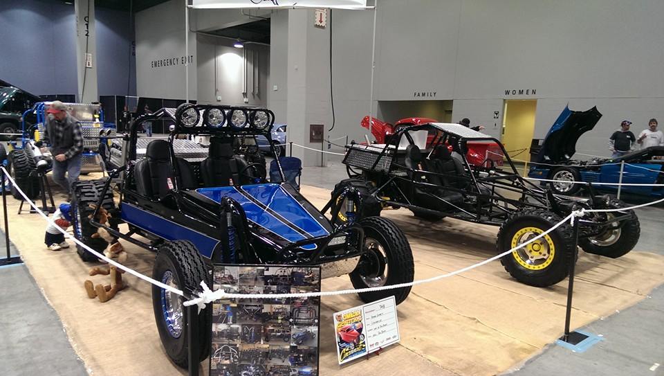

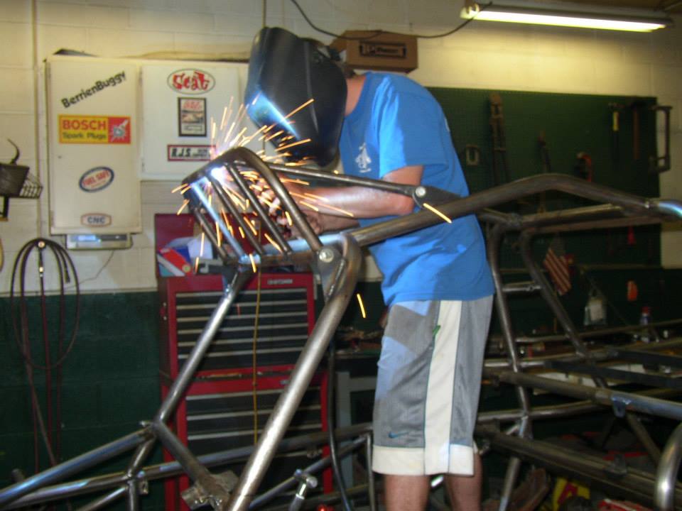

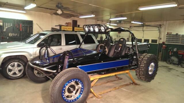

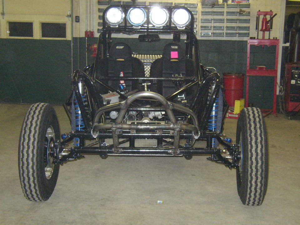

i started this buggy in late may with my grandpa and finished it just in time to put it in 2014 cavalcade of customs Cincinnati which i took first place in buggy class.
Frame: berrien 295
Front suspension: stock front trailing arms, fox emulsion coilover shocks, custom shock towers 6" wider beam.
Rear suspension: 2x3 trailing arms, FOA 2.5" reservoir shocks
Wheels/Tires: empi race trim beadlock rims all around, rear 33x12.5 super swamper boggers and front 30x7 baja pro
Seats: empi race trim seats
Lights: 4- 7" HID lights on top in custom light rack, 6" LED light bar on the front custom bumper, 3" LED light bar for rear back up light, and blue LED strips for interior lights and motor light.
Motor: 2180cc stroker
Transmission: built 3 rib
Brakes: disc brakes all around
Steering: electric power steering

Great looking buggy.. Now that you won the show, are you going to take it off road?

once it warms up im taking it in the woods. i built it as a woods buggy just wanted to put it in the car show before it gets muddy

In that 1st pic. Who kicked that guy in the cods?

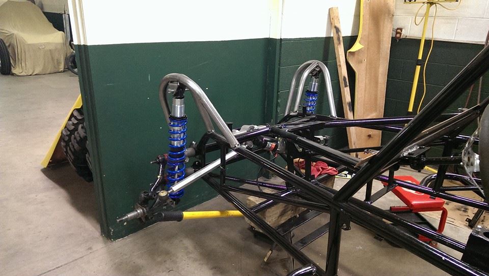

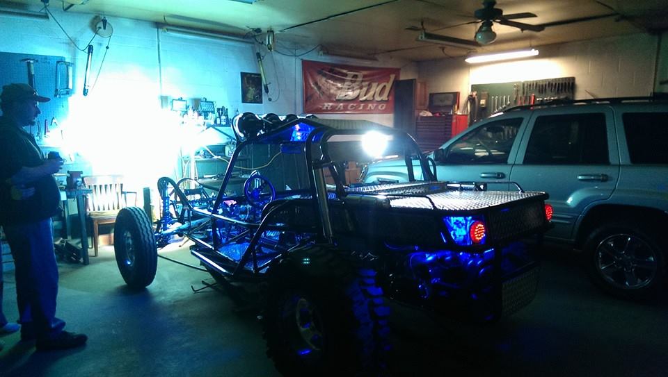

some more pics
File comment: after making the bumper
File comment: all lit up
File comment: mounting the custom shock towers

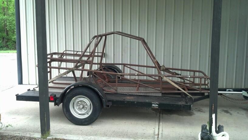

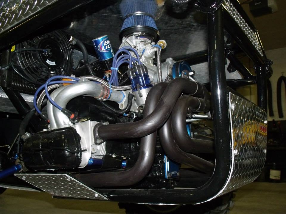

more pics
