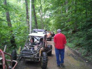

100 inch bee-line frame ,3x3 Dean Marks prototype arms,5 rib with super diff,33 inch boggers on 10 inch beadlocks,7.60 15 firestones on front ball joint front end with 3 inch spindles,Fox 2.0 shocks (just added) with 13.5 inches of travel, 2.2 ecotec with a Phils buggy shack adapter and a Terry fryer harness set up 4 wheel disc wilwood and cnc, kirkey seats and simpson belts just added cree led lights. this thing is built like a tank wich brings me to the most important part thanks to all the people that helped me along the way Dave marks (shadetree) Dean Marks ,Nub Ross (greasy ridge buggy riders)Phil Davis(Phills bug shack) Terry Fryer and woodsbuggy.com
