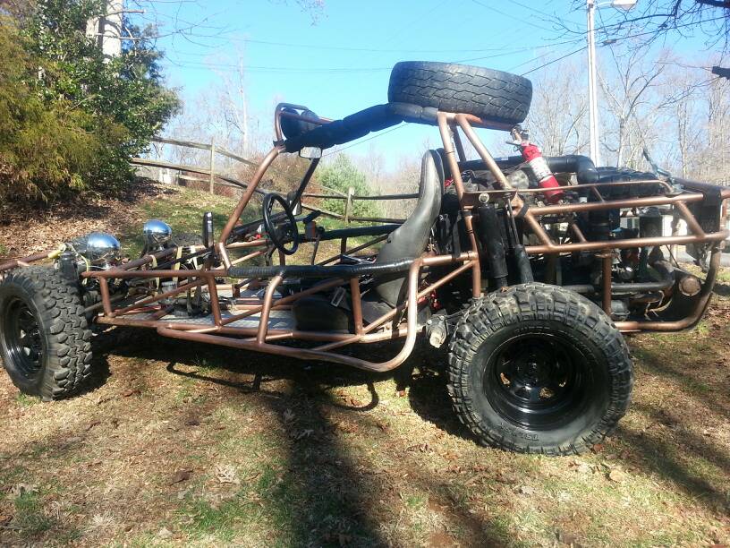

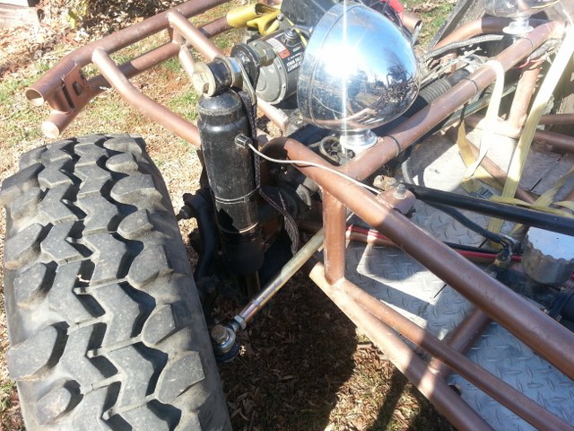

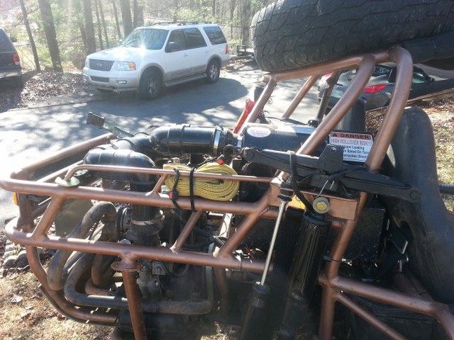

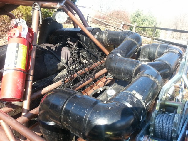

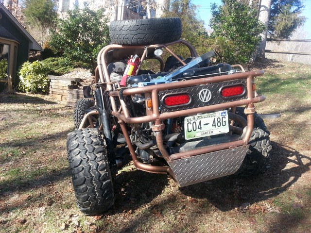

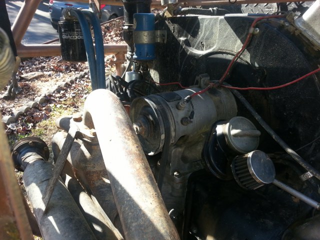

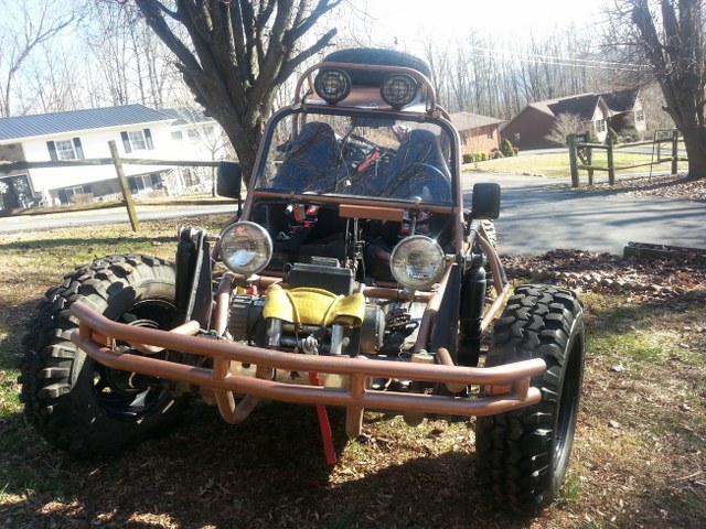

Here's my build. Its not fancy but it gets the job done. My first woods buggy was a Berrien Warrior built in 1984. I finished it in two weeks between school and my part time job. This one is my third and between being laid off and 30 yrs older it has taken me 2 yrs.
*The frame is a Warrior with truck bed option.
*It has a 1915 engine with dual Kadrons connected to an industrial breather.
*3 rib tranny with 930 cv's
*Nissan Sentra rear brakes
*CNC cutters

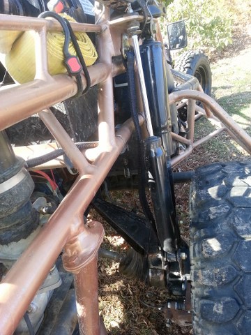

*Dual shocks in back, 1 emulsion and 1 air.
*Air shocks in front with custom towers.
*Seats are Jeep Tj
*6000lb winch with 8000 lb come a long
*Rack and Pinion steering from '95 Grand Am
*And 4 Swampers to make it go.

how does the front end ride with the air shocks on it?
 Post subject: Re: Big D's Trail Rig
PostPosted: Thu Jan 02, 2014 1:57 pm
Pretty smooth. I only have one set of torsion in it. I have thru rods on the uppers. At least I think its pretty smooth. I haven't rode in any ones buggy. Its smoother than factory.

my front seemed pretty smooth till i put bags on the rear...need a little something on the front but trying not to spend a ton on it
PostPosted: Thu Jan 02, 2014 3:25 pm
Those are cheap air shocks. Monroes. $79 2 year warranty. 3rd set on the front. I think I got them set right this time. Got about 600 miles of trails on them this time and no issues. Airline broke once and a bolt broke once. Both times ruined the shock. But
warranty covered it.

PostPosted: Thu Jan 02, 2014 4:47 pm
those super swampers looks pretty heavy, i bet it gives the front end a work out...im running a 670 v tread
PostPosted: Thu Jan 02, 2014 5:06 pm
Yeah pretty heavy. The front end doesn't slide too much though. I also like the look.

Ilike the big tire look, but have since gone to a smaller tire and like the way they handle alot better FAT BOTTOM BUGGY BOYZ
PostPosted: Fri Jan 03, 2014 10:43 am
Smaller tire as in width or height? Those on it are 8x28. I did have to put a rack and pinion on it. My bug steering box got too hard to turn.
