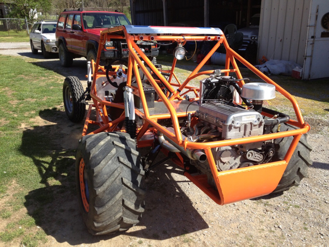

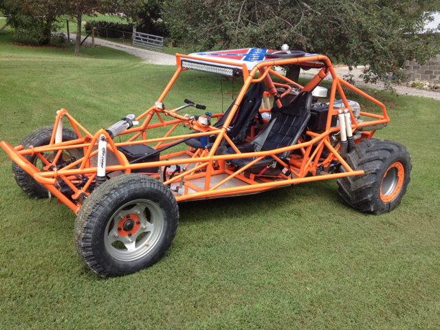

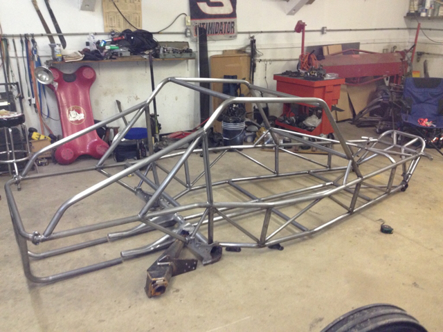

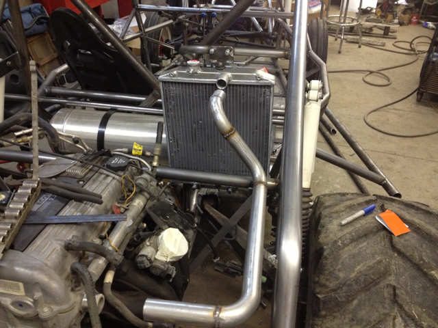

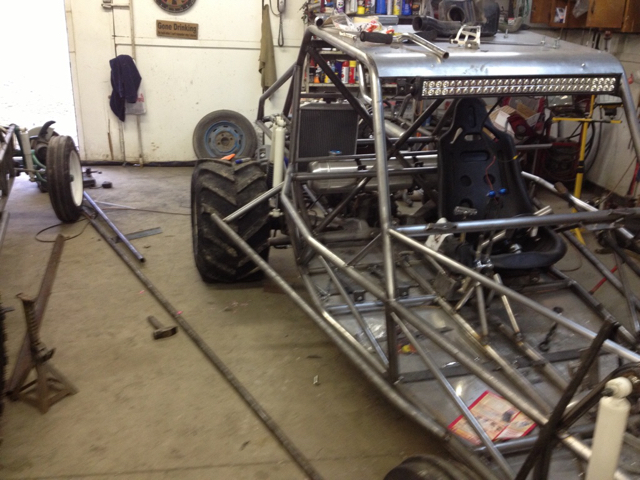

2013 tony Begly explorer chassis. Had some buggies 15-20yrs back, then got into 4-wheelers & side x sides. Then around fall of 13 decided to build a new buggy. But didn't want the issues of air cooled (sorry).
Stock front,w/ discs on separate pedal & Micky Thompson tires
2.2 ecotec stock except header
6-rib stock
2x3 arms & discs
Cnc pedals & cutters
Alum rad for a Honda Civic
Late model wheels w/ 15.5 v-treads
F-150 fuel pump & filter
30" LED bar
Pyle water proof amp & speakers for iPod-iPhone
Viper 5000#waterproof winch
All fab work done by me with wiring help from friends.
Paint scheme from my boy(he's a bigger dukes of hazard fan than I was)
Rode first time weekend before Memorial Day & haven't had the first issue yet. Love this buggy

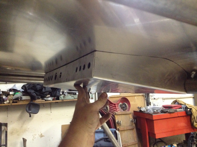

More pix

Nice buggy. There are a lot of guys on here that ride LBL a lot.
 Post subject: Re: Here's mine
PostPosted: Tue Oct 28, 2014 9:04 am
Posts: 34
Nice build, really clean Eco installation, what I have had in mind. I have an Explorer, just had it made 5" shorter. What torsion bars are you running? Mine has the same 2X3 Tony arms with stock IRS 23.5mm bars and an AC currently, too soft. Thinking about going to bags and torsion bar eliminator, cost is about the same as new 26-28mm bars. Yours look like they are maintaining good clearance with the added weight of the Eco motor.
PostPosted: Tue Oct 28, 2014 12:17 pm
Posts: 76
Location: south east,ky
Mine is still a little soft. It'll bottom out if I hit a rut or something pretty hard , gonna try 1-3 more degrees later on this winter. Stock torsions. May have to upgrade

Also, if you're 5"shorter you may have issues keepin th front down. Mine is 104"wh base. & I have the bat,& a winch up front & it feels about the same as the old 100" a/c buggy I had.

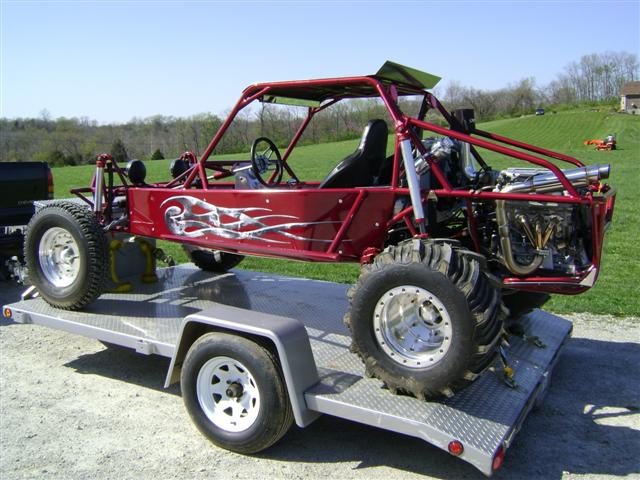

Nice Buggy. Here is a picture of mine. Honda 3.2 it has sway a way racerunner 2.0 air shocks. there are no torsion bars in the rear.
What frame is that?
PostPosted: Tue Oct 28, 2014 8:48 pm
Posts: 159
Location: Okeana Ohio
Bee Line Explorer

I didn't want to take away from your thread. I was just wanting to know you can do different things to the suspension to get a better ride and not bottom out. those air shocks have worked good for at least 4 years now.
