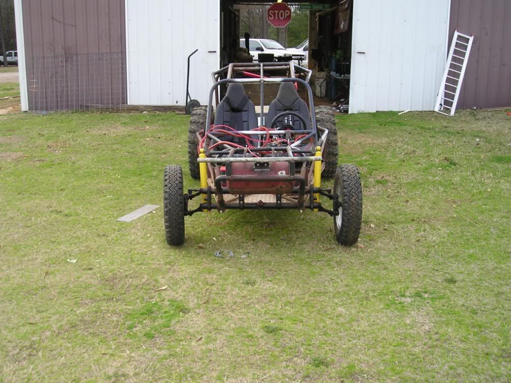

 Post subject: IT IS RUNNING
PostPosted: Mon Aug 04, 2008 2:34 pm
Joined: Mon Jul 09, 2007 2:38 pm
Posts: 222
Location: aiken sc
i finally got it running and i have just been beaten it around the farm trying to work out some bugs heres some pics
loaded up ready for its first real ride at a off road park
well thats it for now let me know what all of you think of it
this has been a very long build for me and im very glad its done glad i did it at the same time because it has made me want to be dedicated to 2 wheel drive off road lol and i have also learned a grate deal of stuff form it
