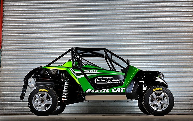

Here you go:
File comment: SxS Roll Cage
CDS or T45 (similar to your 4140), MSA and FIA approved, bolt in rear diagonal/cross available too.

Your chromoly specs look a little low, our T45 (similar but forms a bit better and welds better) is about 110-130,000psi tensile. Generally it comes on the upper end at 130,000 with a yield around 100,000psi.
We save around 45lb on a full frame using T45 instead of DOM/CDS.
Not sure what the saving over welded tube would be as we don't use it, as it can split down the side of the weld seam in a big impact.
Some people do use 'steam pipe' which is welded and then run over a mandrel to cold form the weld for pressure vessel use, which is probably similar, usually in .1375" wall thickness for 1.5" and 1.75"OD tubes.
On the one we work on for a friend that ends up with a frame weight of 330lb just in tube/weld/brackets :shock:
So if we made it out of the equivalent in T45, you could expect it to drop in around 160lb for a similar strength frame.
In reality some tubes that get floor contact you would keep similar thickness unless you go to the extreme of foam filling, so probably around the 180-200lb mark. Still a fair weight saving.
