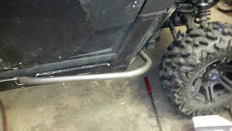

PostPosted: Sun Jan 19, 2014 2:05 pm

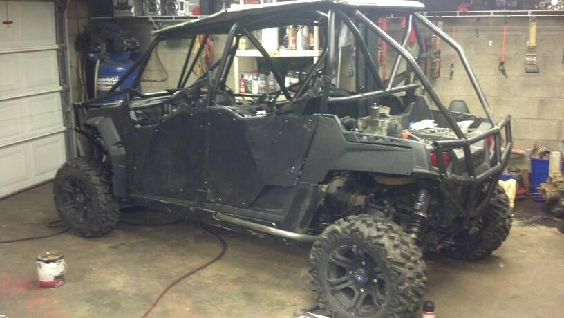

PostPosted: Wed Jan 22, 2014 4:44 pm

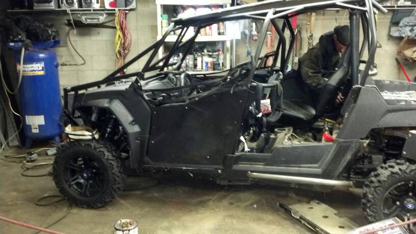

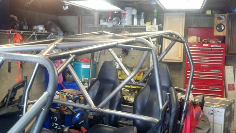

Worked on the RZR last night .... Starting to come together now
PostPosted: Wed Jan 22, 2014 5:24 pm
thats a lot of roll cage 8)
PostPosted: Wed Jan 22, 2014 6:31 pm
I agree Rick I think I over caged it but it is safe and I would roll it without a worry lol . Hell if I ever see you in the woods me and you'll get it out and be the first to roll it.
PostPosted: Wed Jan 22, 2014 8:39 pm
Of course I don't think that guy owns it would appreciate it lol

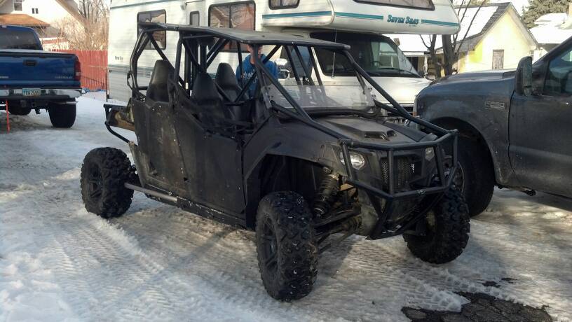

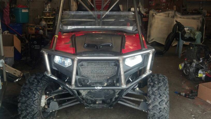

The rzr is getting close....a few more pics for you guys rinolined the body got the cage back on....
PostPosted: Wed Feb 12, 2014 10:39 pm
A few new pictures

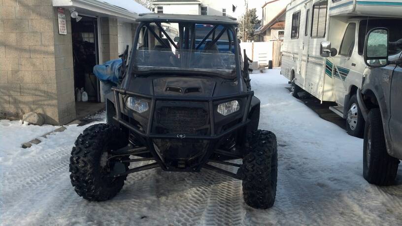

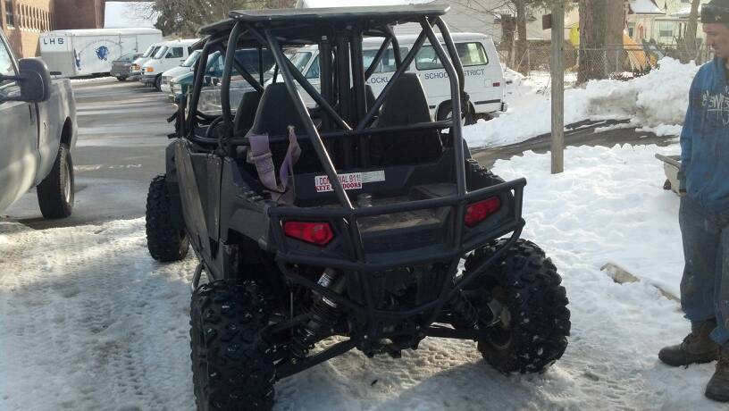

PostPosted: Thu Feb 13, 2014 10:47 pm
Got the razor outside today
