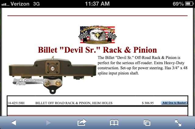

Look at my buggy build. I used a devil sr. Rack. 300 bucks but I don't think you will ever need a spare. It's been good so far. My bro runs a Saco and a few buddy's do to and they are hard to steer to me. I can drive mine with one finger. Drill your arms out on your spindle to a 5/8 hole and run hime joints

PostPosted: Tue Sep 17, 2013 12:39 pm

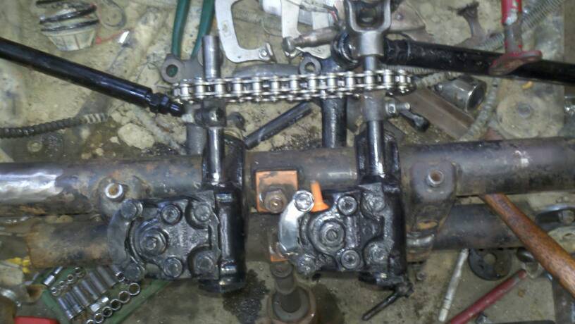

PostPosted: Fri Sep 20, 2013 12:22 pm
One in center will work but 2 in center is b.a. chained together so they work together and strong

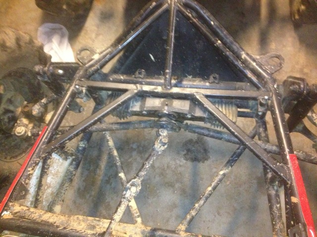

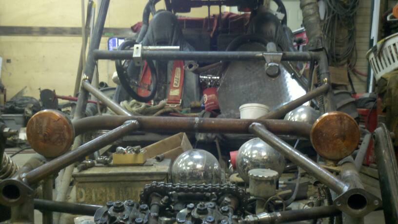

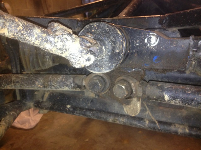

PostPosted: Wed Sep 25, 2013 11:02 am

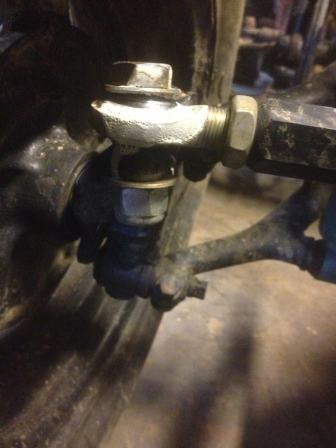

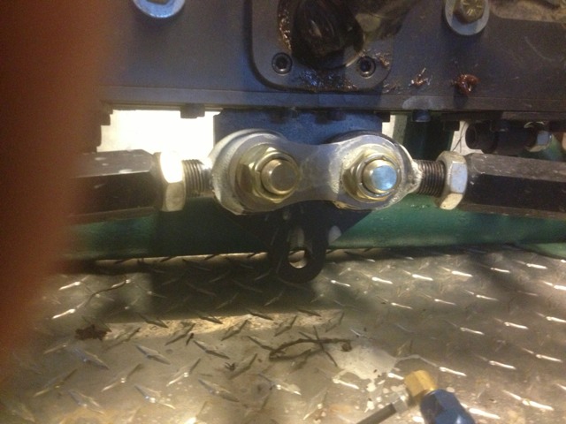

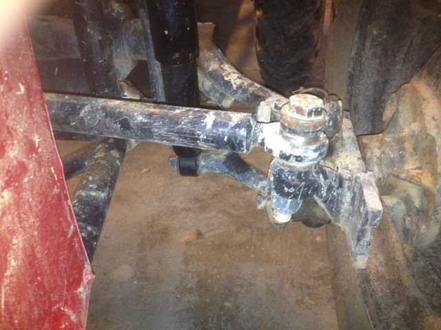

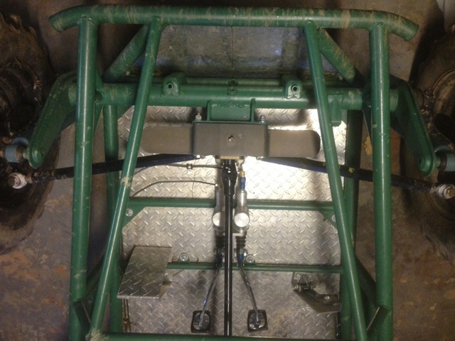

Devil sr. On mine

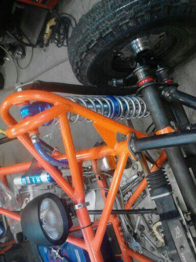

Saco on my orange buggy.
