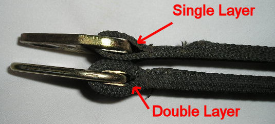

I don't think will break a quality quad strap.
Call Offroad Engineering. They have every size made from 5-40 inches.
Michael Randolph
San Diego, CA
1-619-298-4455
Michael@Offroad-Engineering.com
http://cgi.ebay.com/ebaymotors/beard-li ... .m20.l1116
Difference in dual and quad straps.
