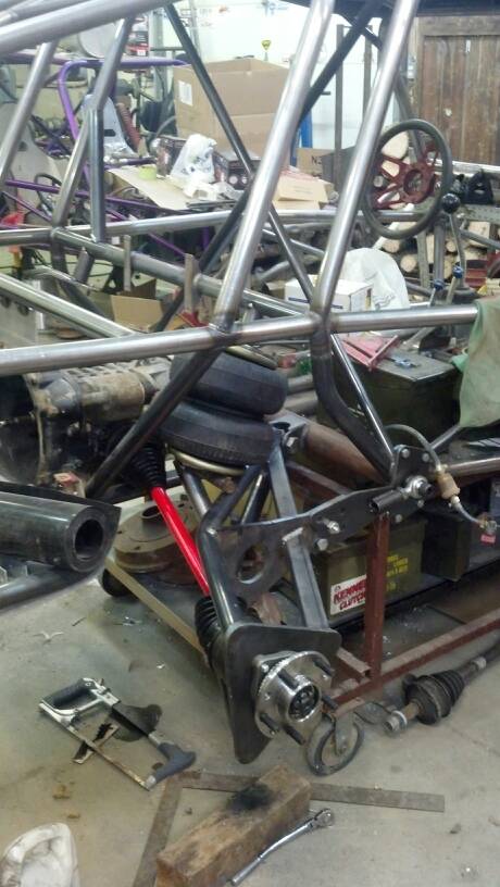

Image in the pic it looks like the bags attach to the bar under the fuel tank....there is actually a thick wall tube behind that one that the top of the bags mount to...and a 3 point mount on trailing arm

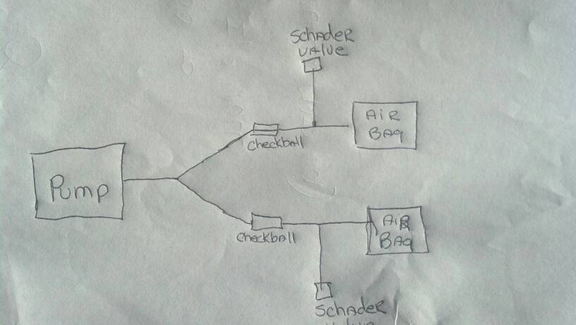

If you put a pump onboard you have to run one way checkballs before each bag, otherwise when the pressure increases in one bag it affects the other.
PostPosted: Fri Nov 08, 2013 10:02 am
Here is a crude diagram that may help
PostPosted: Fri Nov 08, 2013 10:03 am
Sorry schrader valve

My air bag with valve stem set up on 8x5 arm built by buggybarn(aka nick) but lpb on bag mount
