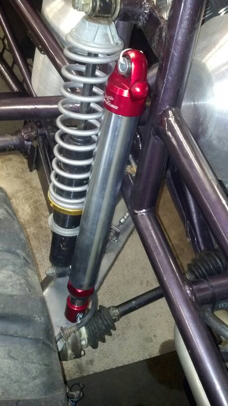

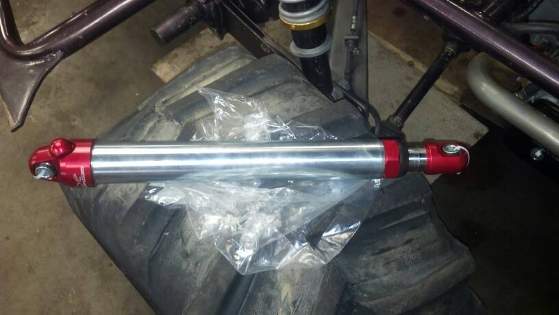

Have any of you guy ever ran a set of Racerunner 2.0 sway away air shocks ? I just bought some they support 1000 lb per skock . The fox 2.0 says 550 lb per shock ... :? This shock looks really nice any body else running these any thing i should know good or bad ?

The Fox says 550lb per shock because if you're them at anything above that they get insanely hot and lose damping control, you also get masses of seal wear from the pressure.
The same thing is going to happen with the Racerunner units, given the same size and config, the outright numbers are pretty meaningless bar the max pressure the damper can run at.

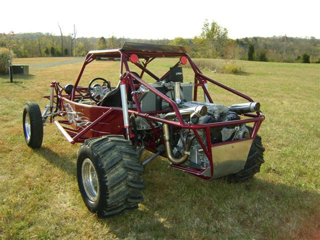

I have them on mine. I have had no problems for about 4 years now.

That's cool....How do they do ith that v-6 on the back of that buggy.
PostPosted: Sat Dec 21, 2013 11:40 pm
That's a sharp buggy trailrider
