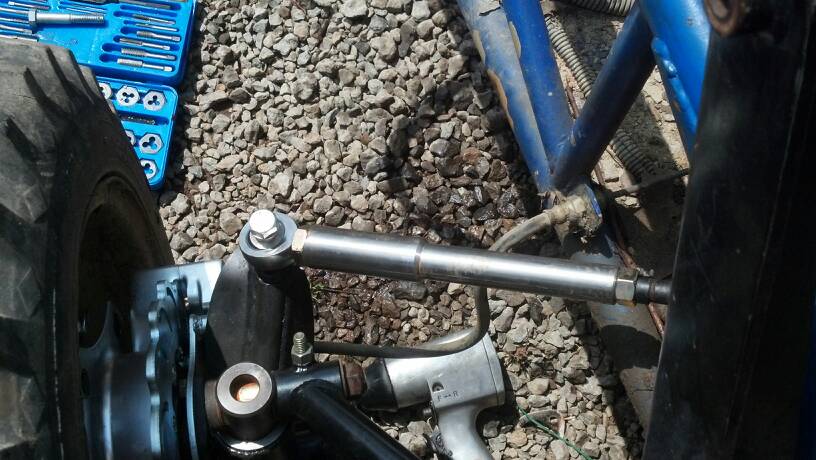

Here my grand am set up

Clean looking setup. Where did you get your tie rods? I think MadMike made mine for my VW steering.

Correct me if I'm wrong , Andrew yours is a end load rack like mine, big D urs is a center off the earlier grand ams, nice set up andrewha, big D keep the pics comming I wanna see the finished install on the center load rack

Yeah sorry mine is end
He made those too he does great work
