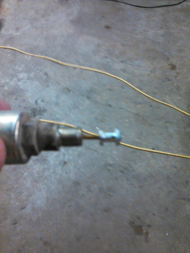

I am having a problem idling so I cut to whole copper piece and float off? And still plug the wire back in?
PostPosted: Mon Aug 25, 2014 9:50 pm
Just clip the wire off or plug it back up. Old solex's are bad about butterfly bushings going bad. Spray ether on them and see if it idles up for a second er 2.
