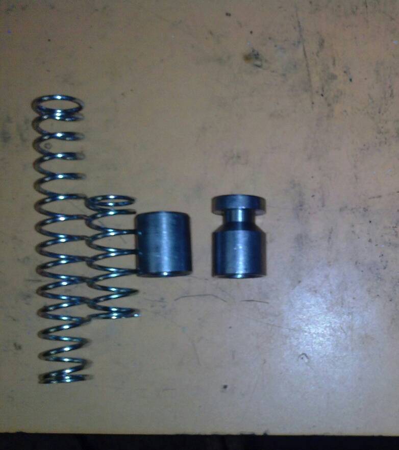

I got an external oil cooler and it came with new relief pistons and springs. The springs are a lot stiffer than the old ones and one of the pistons is different than stock. Should I put these in or use the old ones? Where does the different piston go? I'm eliminating the shroud cooler and running everything through the full flow. The cooler kit is supposed to run off the adapter that replaces the shroud cooler.

PostPosted: Tue Nov 19, 2013 8:26 pm

Keep the shroud cooler ...And run the other cooler with it. Keep the old springs too .

If you must use the remote oil cooler, run it from the full flow fittings, not the oil cooler adapter. Always KEEP the stock oil cooler in place no matter what kind it is. This is important.
