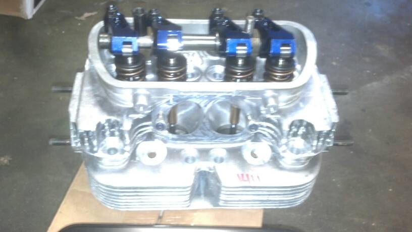

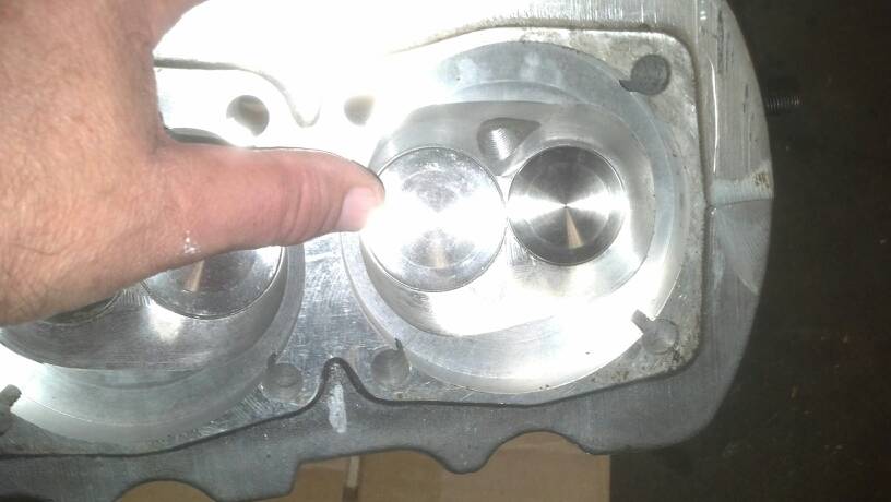

these are 044 wedge port heads that I am getting ready to put on a 2500

If I were building that engine I would opt for the los panchito CNC ported 044's. I also would run no bigger than dual 40mm carbs.
