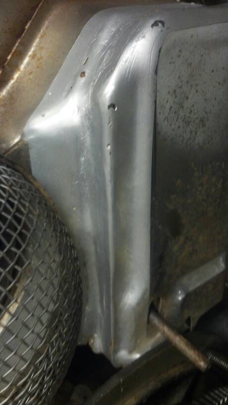

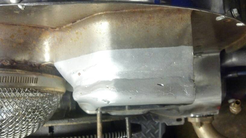

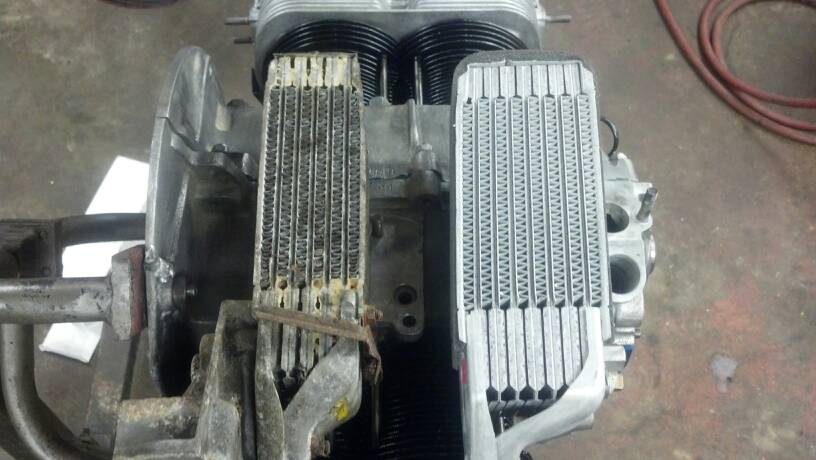

Put a type 4 oil cooler on it modify the fan tin to accept the bigger cooler. run the inline cooler if you choose to . Then you are for sure not gonna overheat
