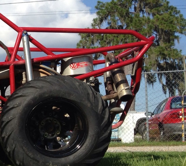

Buy a ceramic coated collector with u bend and add muffler
 Post subject: Re: Exhaust
PostPosted: Fri Dec 13, 2013 8:39 pm
Example for you visually

What kind of muffler is that?
PostPosted: Fri Dec 13, 2013 10:22 pm
Bug pack Stainless glass pack

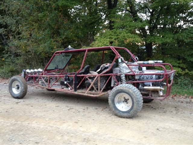

PostPosted: Fri Dec 13, 2013 10:34 pm
http://www.mooreparts.com/945-AC251065/
Moore parts $88.00 plus shipping
