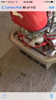

I made some small aluminum brackets thats held down by the mounting stud
