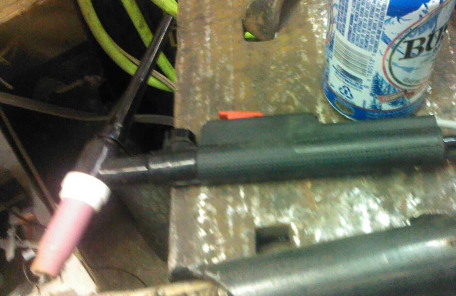

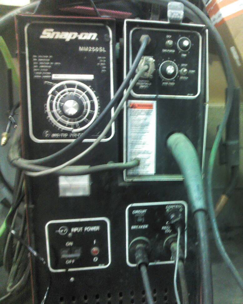

I'm using a snap on mm250sl mig/tig welder with the scratch start tight torch made for it. You just unplug the wire feed box and plug in the tig torch. I've tried reversing the polarity, and all settings but can't achieve an arc. Welder works great as a mig so I'm sure nothings wrong with it. This is definately operator error

PostPosted: Sat Nov 09, 2013 9:20 pm
And before there's any more jokes NO the problem is not the beer sitting next to the torch:grin:
PostPosted: Sat Nov 09, 2013 9:33 pm
thats a nice welder . but it will not weld aluminum its for welding ferrous metal only. I highly doubt that you can scratch start aluminim because you gotta use pure tungston electrode and when you sharpen it your supposed to clean all the metal off the grinding wheel so when you put the point on the end of the tungston you dont contaminate the tungston rod. In the process of scratch starting the arc your touching the tungston to the aluminum and it will contaminate the tungston, thats why when you weld aluminum you have the high frequency start on your tig so when you push down the petal itll start the arc so you dont have to touch the tungston to the aluminum and contaminate it. even when your welding your bead, if you acidentaly touch the aluminum with the tungston that point will turn into a ball so you have to stop and pull the tungston out and resharpen it. actually it is a pain in the ass welding aluminum for a beginer.

PostPosted: Sat Nov 09, 2013 10:27 pm
Thanks guys I really appreciate all the help. So I'm guessing I contaminated the tungsten when I tried it on the aluminum and that's why it won't achieve an arc? Can I just cur it off and regrind it or is the whole stick of tungsten junk now?
PostPosted: Sat Nov 09, 2013 10:59 pm
Posts: 24
HP
Your Tungsten is fine you can just regrind the contaminated end. Most often when a scratch arc machine tungsten becomes contaminated it won't hold an arc.As the old saying goes it needs a clean start ....

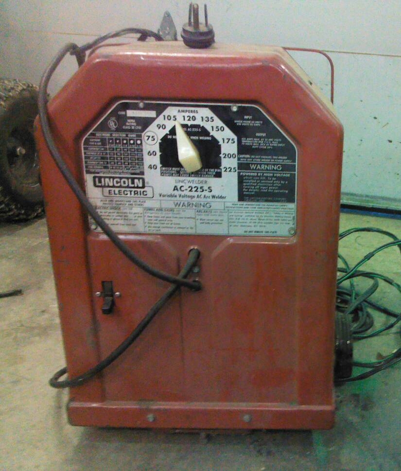

OK I scratched the tig welding idea. Thought about buying new manifolds but all I can find is EMPI for my application. I've sworn to myself I'll never buy another EMPI product EVER. so I searched craigslist for an arc welder and found this old tombstone. Hopefully this thing works and I can figure out how to weld aluminum with it. Any tips or tricks on how to use this dinosaur?

PostPosted: Sun Nov 10, 2013 4:40 pm
Posts: 292
Location: Charleston WV
Looks like a AC welder if your going to stick weld aluminum it works best DC. But I still can see holes blown in your intakes. I wouldn't loose any sleep over the ports not matching up as long as the gasket will seal it. You may be looking at 1-4hp difference if it was a perfect world and the ports matched.
Travis
PostPosted: Sun Nov 10, 2013 5:17 pm
Yes it is an AC arc welder. I tried it and it sucks as well. Looks like I wasted my money. Oh well.
I wouldn't be concerned about it if it was a small difference in ports but its not. My air/fuel mix will come through the intake and hit a ΒΌ" ledge. I'm sure that's going to be a serious loss in HP and drivability. When it comes to engines I'm a bit picky and this issue REALLY bothers me.
