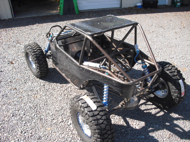

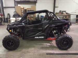

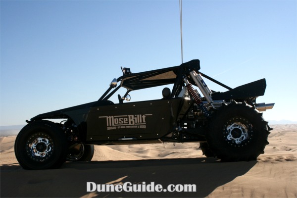

will this work. not as pretty but is it too tall. i know its a crawler but i like the forward cab and height. or a stretched rzr style or sand buggy.

Im really curious of how the mid engine handles. Does anyone have any suspension expertise. Im thinking the rear trail arms should mount as far forward as possible. Not for travel but better weight distribution and traction. Anyone?

Psycho Alpha i know what your thinking, this guy is all over the place. Which is why I built my first buggy 3 times before it was done. I HAVE A.D.D. But I will get to the sami drive 4x4 rzr soon enough. That mid engine subaru was pretty long. Well longer than I figured but thats ok It will be what it is. That thing climbed well. Hard to see how it was built. And the ls buggy was nasty. What do you think of the mid engine?
PostPosted: Fri Feb 06, 2015 9:11 am
I think it is a good idea, but you will have trouble fitting it all into a usable sized package (wheelbase), and the weight distribution will be off what you want for a woods buggy. My race buggy is just a little more balanced (front to rear) than an average woodsbuggy and wont climb worth a shit. I do like the idea and not using a bus trans in theory is great!!!
PostPosted: Fri Feb 06, 2015 9:15 am
I know how that goes, it was 8 years from idea to driving my buggy! Mid engine makes harder to get power to the ground but it should work as long as you get bias right.

you would think that the weight in front of the wheels would be better than behind. Maybe its weight pulling down and the tires digging in better because of that. well im gonna try it anyways. Maybe it will be great and maybe it will just be a buggy. My thinking is that the trans will hold the power considering it holds it from stock and that car weight 3000 pounds. I wish I had room to fit chaindrive in there too so I could take the load from the cv. But for chaindrive just run a fwd car engine and have the cvs mounted towards the front of trail arms and chains back. no special trans or parts minus the chains and adapters. Next time, it was gonna be this project but i got a good deal on a suuuubaru.
