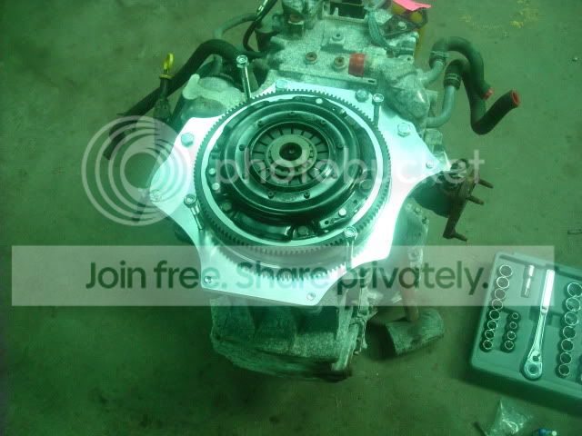

well over the weekend I got to start my motor swap. I going to be running a 05 ION 2.2 so far i just got my new arms on just got one day to work last weekend but next weekend i plan to have the trans and motor in.
here is what i have so far

well got so work done on the buggy today we got the trans and motor on :mrgreen:

Ok nowaway from the bullshit that you post on everyone's damn build thread....
Nice set up..nice starter adapter...who makes it and what starter do you use with it?

thanks guys, I got most of the fuel and rad. stuff made up today and I think next weekend it will be making some sound.
also anyone going to do this I had a hell of a time getting the motor on the trans over 3 hours I dont know if others have had probs. to but I have never had that much probs. with a motor. :? :cry:

ok if you wont tell :lol: Enginewiring.com done it and they done a great job but i do have one plug I dont have any idea where it goes :shock:
If anyone does it would be great its a small plug 2 wire I looks like it would go to where the starter would be there is a longer one just like it i think it goes to the air temp. anyone know

Smog electric air pump?(optional)Also there is a vacuum switch that is elecrically controlled by the ECU(compt) for the EGR valve.Everything smog and EGR I clipped or plugged.And it may be the OAT Outside Air Temp.
