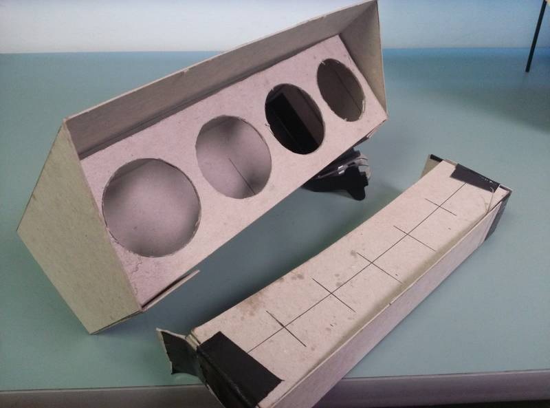

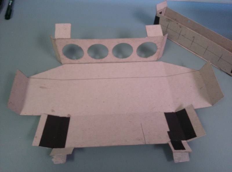

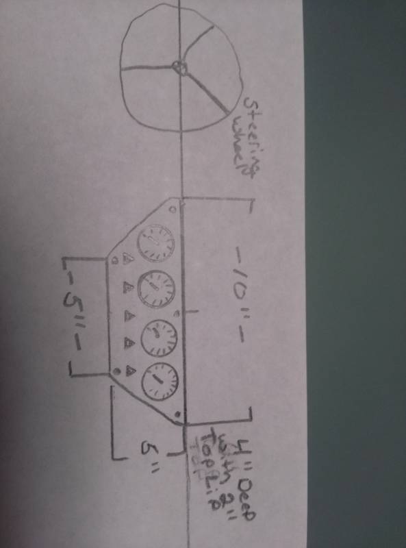

Couldn't find a gauge pod to fit four gauges or maybe the 9" ones do, I don't know. So I decided to make a template that is 10" to fit four, I then made sa switch box template to fit five flip up switches to go overhead. I then seen something like my drawing and am going to go with that instead of trying to make all those bends.

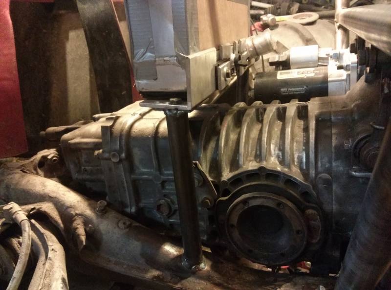

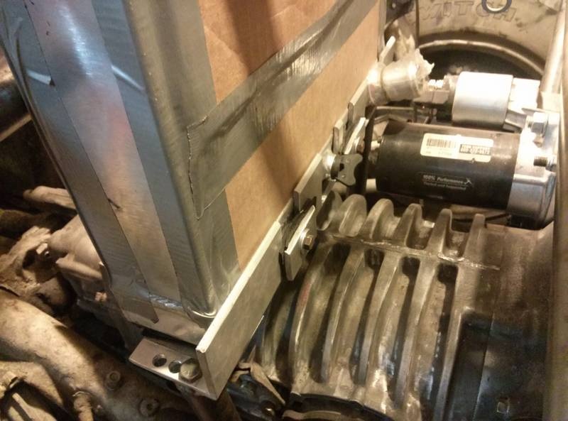

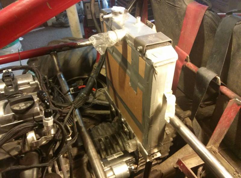

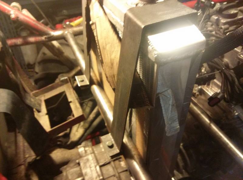

Got the radiator mounted today, tomorrow will be the gas tank and starting the hydraulic pedals.

What do you guys think?
PostPosted: Wed Mar 05, 2014 7:25 pm
Is that radiator gonna be big enough?did you get the 2.2 or 2.4?

My thoughts as well... but don't use my car as a gauge because it was overkill. We run in the desert when it can get to 115 degrees so I needed a little more cooling. The fans are supposed to cool up until about 15 mph when forced air is supposed to take over. If you are doing a lot of off and on running you may never have an issue but if you go on longer trips you may tend to over heat. Rule of thumb on cooling, go with the largest radiator you can fit into your designated area.

I got the 2.4, the radiator is a honda civic 3 row racing radiator, it's 3 inches thick,14" wide and 16" tall, I do have a fan to put on, most of my riding is trail, rarely leave 2nd gear. I have seen these used before in other build researching. I will keep an eye on the temp!!! I have room if I need to go bigger.
