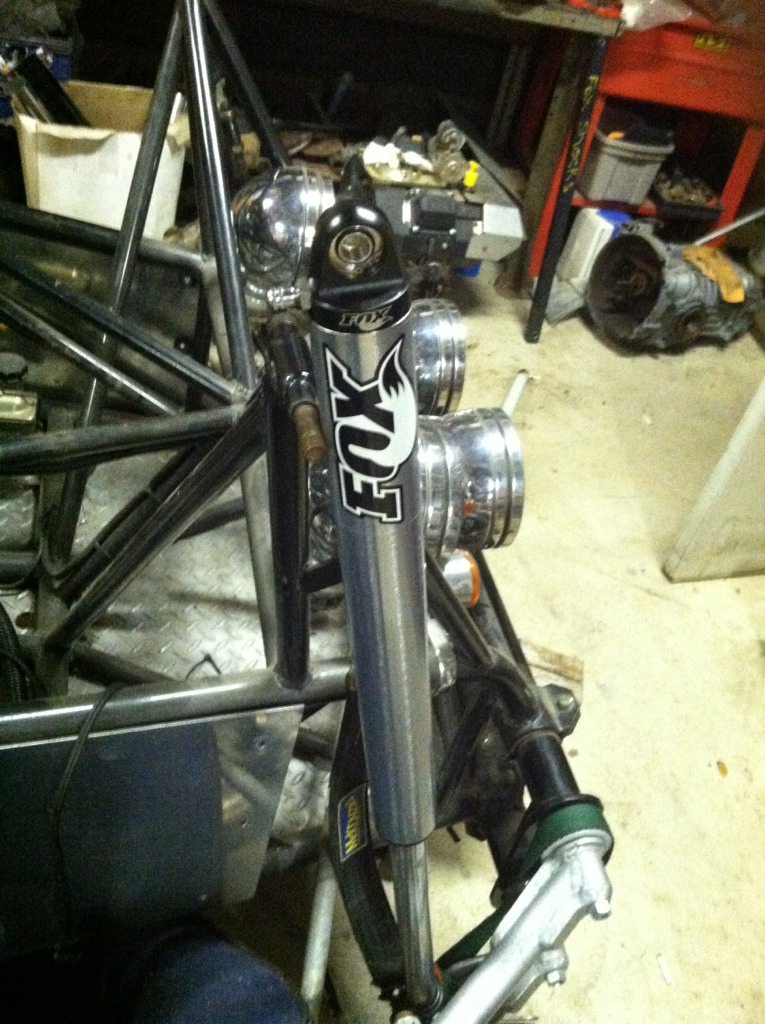

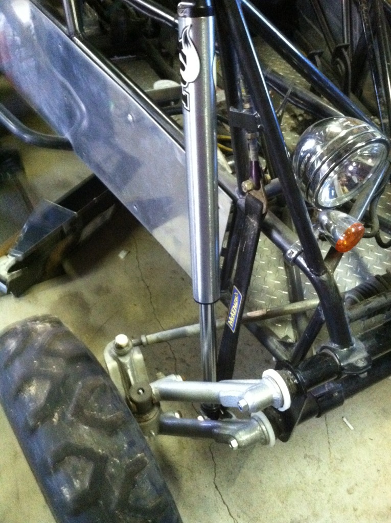

ImageImageImageImagethese are the rear 4x4 arms me and dave built , they will have 1/2 ton chevy wheel hubs and the stubs will be machined to work like a micro stub . all the tubing was 1 inch chromoly .
ImageImageImageImageImageImageImageImageguess who did a fine job on my new bad ass front end .......
Imagemy very good freind tonya (aka) ruttrider finished my wire harness and did a great job !!!ImageImageImageImagejust rolled the tires up to her to get a idea of what she will look like . lol
PostPosted: Sun Apr 29, 2012 10:56 am
Curious why the short spring is on the bottom of the shock? Techinally it should be on the top. I can only assume it is the stiffer of the two correct?
BTW Is this project ever gonna get Done! :roll: :wink: :mrgreen:
PostPosted: Sun Apr 29, 2012 8:25 pm
I'm not real sure I have not researched the shocks at all . That is how the was setup when I got them . What all are the steps to setting them up correctly if you don't mind helping me .....
Also I hope to have it done in a month or two cause of a little drought I'm going threw :cry:
PostPosted: Sun Apr 29, 2012 10:15 pm
The Main spring (bottom) should be the longer of the two and also have a stronger spring rate then the Tender (top). Typically you want to stay with in 100# of each other. As I recall both of the springs on those shocks were of the same rate. I suspect they were changed to accomadate the heavy V8 motor and may be to high of a spring rate for the Subie setup. The rates should be marked on springs.

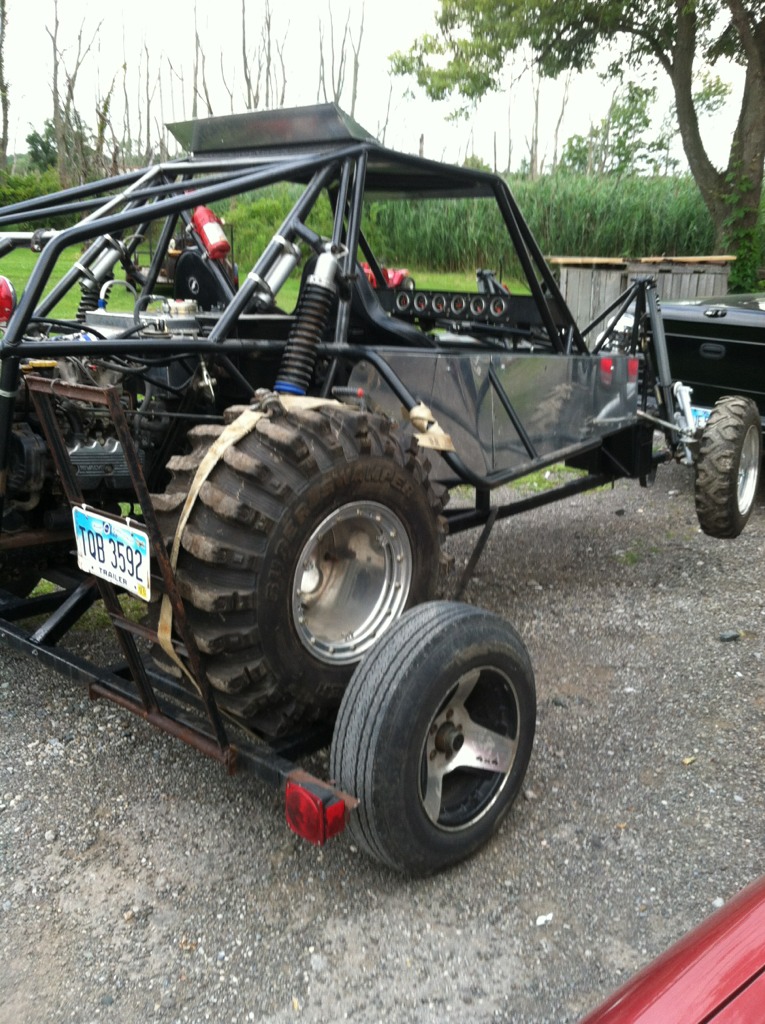

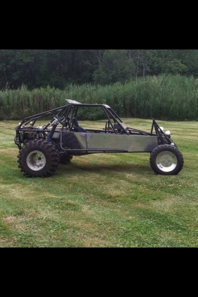

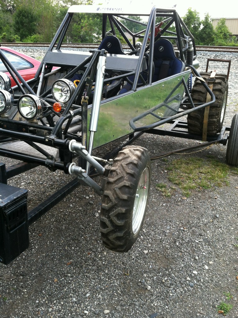

Here is some pictures of what she Looks like now , just need to get some extra time to finish her up and go ride !
PostPosted: Mon Sep 09, 2013 7:51 am
ImageUploadedByWoodsBuggy1378727417.818190.jpg [227.53 KiB]
Downloaded 71 times
ImageUploadedByWoodsBuggy1378727444.401862.jpg [237.94 KiB]
Downloaded 71 times
ImageUploadedByWoodsBuggy1378727488.721491.jpg [270.93 KiB]
Downloaded 71 times
PostPosted: Mon Sep 09, 2013 7:53 am
ImageUploadedByWoodsBuggy1378727530.604489.jpg [355.13 KiB]
Downloaded 70 times
