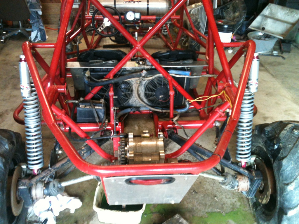

My main goal is better safety(my head is at roof), comfort(can't get susp seat in there), and performance(moving some weight back,the front never gets light).
*GONNA TRY AND DO SWITCH IN 30 DAYS FOR JULY 4 RIDE IN THE VILLE*
My current buggy stats
105" wheelbase
1x4 front arms
3x3 rear arms
Walker Evens coilovers
80" wide at rear tires
29" rear tires
17" ground clearance
1300lbs
2006 GSXR 750cc engine
145 HP according to goggle
Jeffco transaxle
Image Image Image Image

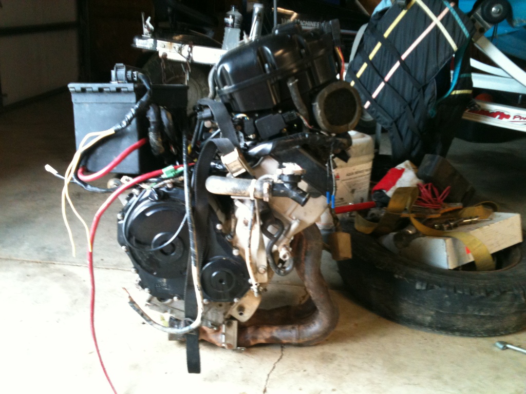

PostPosted: Sun May 31, 2015 7:02 pm
Got all the tube bent for changes to run gsxr powertrain Image was going to run them vertical but like the look with them turned outImageImage

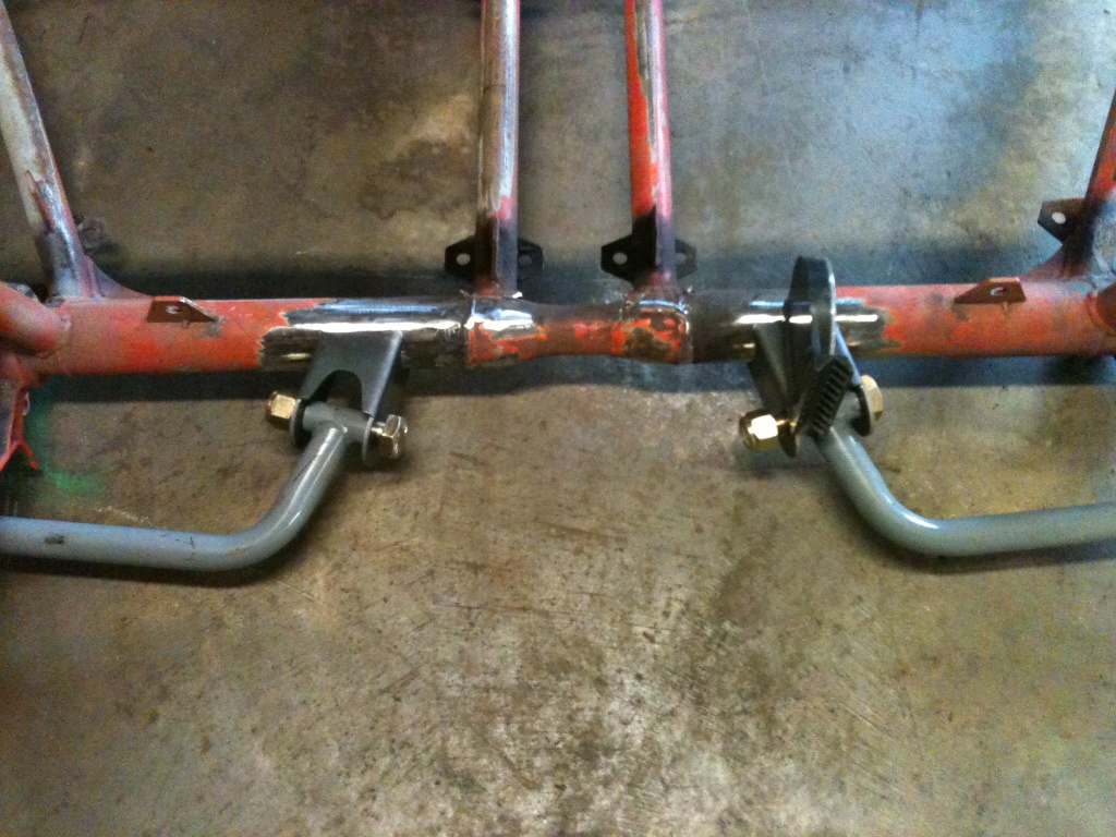

PostPosted: Sun May 31, 2015 7:07 pm
Frame all ready had torsion housing in it so I was gonna leave it alone. But didn't like how it thin horns where and how it looked looked. So it's all coming out and getting aftermarket irs pivotsImage

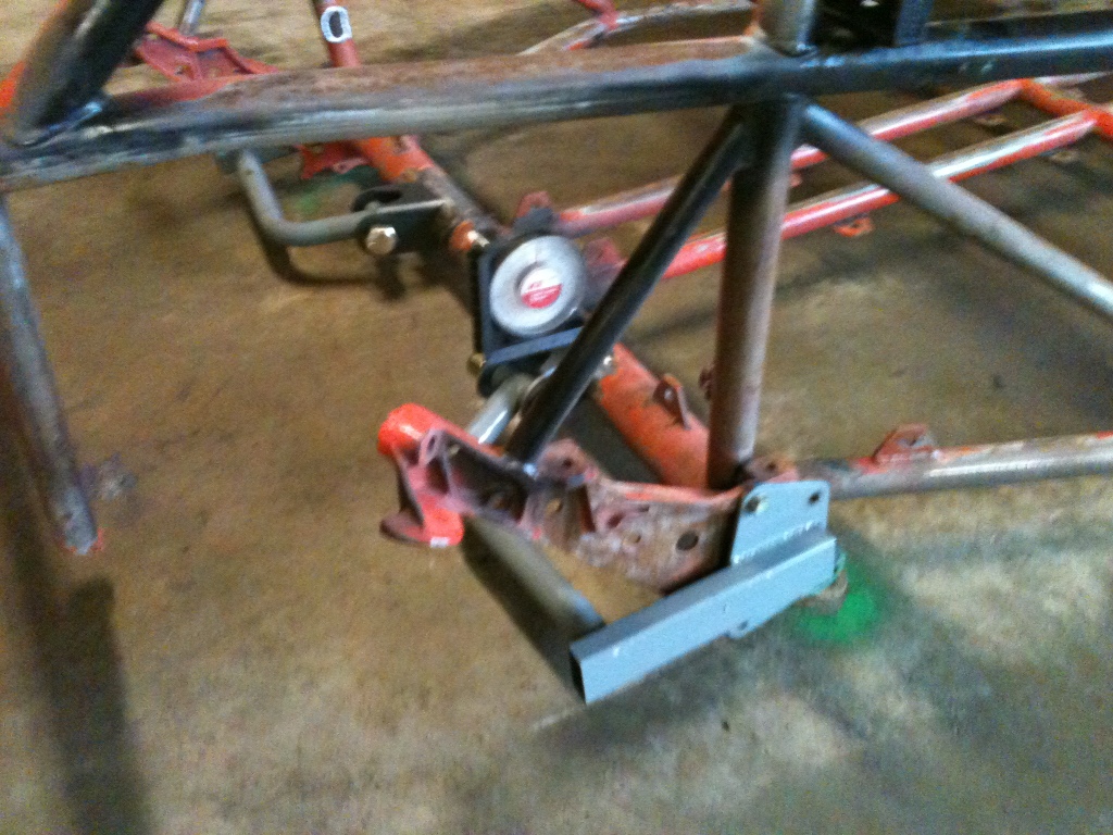

PostPosted: Sat Jun 20, 2015 7:37 pm
It took me 7 hrs but I got all the stock stuff cut off beam and cleaned up for new IRS pivots.
Question any on remember how many degrees the pivots are set at....... 7*?

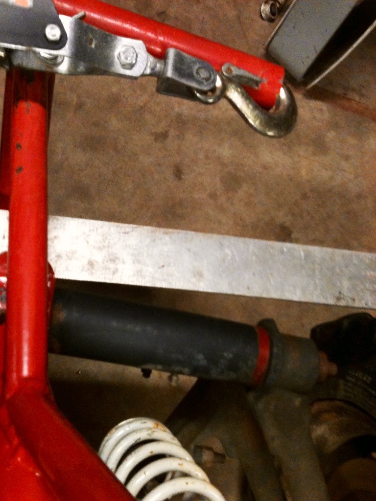

PostPosted: Mon Jul 06, 2015 8:20 pm
After I stuffed buggy into a bank and bent the front beam, I pulled the trigger on tearing down buggy.
