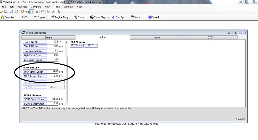

jimp wrote:
Thank you for posting on this! Can you also post your baseline
parameter settings? What software do you use for your OBD?
We use HPT. We tune the E67 in speed density which requires advanced knowledge of virtual VE tables and a secondary 3-rd party software. The MAP settings are STOCK on ALL naturally aspirated setups. We do nothing to the MAP settings it is not needed. I've attached a screen shot of where you would change the MAP scale in a BOOSTED version along with a compare of it to a stock file.
