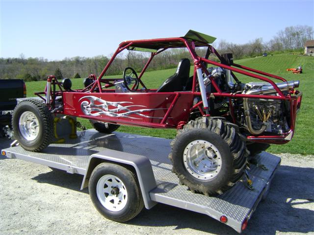

I am running the Honda 3.2 vtec for about 6 years now with out any issues. there is no comparison to VW. instant throttle response and plenty of power when you need it.
PostPosted: Fri May 29, 2015 6:51 am
That's a badass buggy!!
PostPosted: Fri May 29, 2015 8:31 am
Yes it is!!! Badass looking and badass!!!
