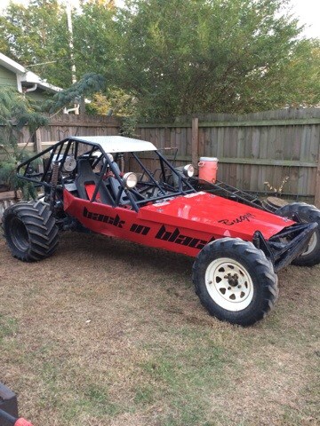

what are you thoughts on this one? its a two seater though.
http://woodsbuggy.com/forum/buggies-4-sale/17398Image
Nribuggys on here use to own that buggy it's a well built buggy it will hold up to any type of riding and hill climbing but he sold it without the motor so I'm not sure how good the motor is ? I have seen it climb a lot of bad hills. Good luck and welcome to the site

I'm sure it's a lil far from Canada lol. But we can just say it's been put threw the test. As far as the other Buggys. I've seen them all on the samba and that cobra buggy may be a turd but it's looks BADASS. But with no motor or trans that could be expensive depending on what u want. 2500 and the right trans I'm sure it will give ya the "SHAKES"
