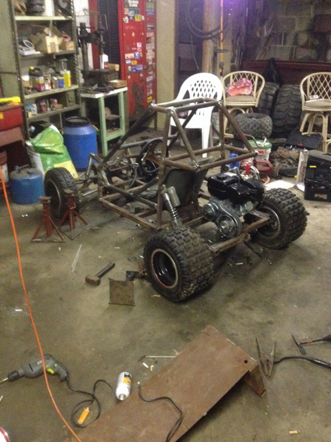

finally getting somewhere

That looks awesome but it might get heavy with that big of a frame
Can not wait to see the progress..

That looks great. Very good job. My girls want it already just from seeing the picture. It looks likr a good mini for a 12 or 15 hp engine with a big sprocket on the axle . I know i would go with a way to steer it that would be easy and wont rip the wheel out of her hands. My girls on theres were focusing more on trying to steer it more than anything which made it dangerious. The stock go kart steering is junk. Im sure you already no that but i couldnt tell what steering you are using. Again great job!! Love it.

Thanks I no she is excited to ride it I ordered a cheap rack and pinion and I'm not to sure how the gearing will work on this setup with the 6.5 hp I kinda wished It had a diff in it so I could put a cutting brake In it.
