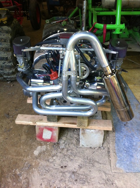

My new 2275 happy happy happy

I would scrap the tin top and bottom air cleaners and get the aluminum ones. They'll cause nothing but problems.

Brad u know it will run like a top with just 1 Weber 44. Heck with the duals
 Post subject: Re: New 2275
PostPosted: Tue Sep 10, 2013 3:47 pm
Duals are way better if you get them dialed in. I ran a single on my 1915 went to duals and it was a totally different motor.

A single is much easier to deal with though.

x2 Their junk.

I ran the same stinger for years. It is great but you will lose a lot of Horse Power. It is 'night and day' when you take it off. In addition, the stinger will blow dust like crazy.
I ran the stinger when I was driving on the street but pulled it off when I was driving off road.

I'd get rid of the U-bend stinger as well...you'll always be the last one to climb the hill or the last during trail riding..no-one will want to follow you cause they blow dust BAD... :shock:

Yea I have one that just goes up and that's the one I'm putting on there
