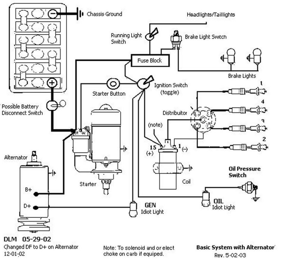

Just wondering how to wire the disconect switch so that it functions as a kill switch. Would you run B+ from alt. to battery side of disconect switch instead of to the starter? Since you can take a battery out of the circuit once the vehicle is running as alt will continue to provide 12V.

how about for the reverse lights off the trans? is it wired like the inline brake switch. permanent + on one side and the feed out on the other?
It is the same as the inline brake switch, just double check the switch with an ohmmeter to verify switch is OK before wiring it up....

PostPosted: Sat Apr 05, 2014 8:14 am
Joined: Sun Mar 16, 2014 7:20 am
Posts: 36
Location: Scioto County, Ohio
I cleaned this up a little for my printer at home, its a little clearer and only black and white, I printed it at 200% scale and it fit on a regular piece of paper (so I could have it on hand in the buggy).
