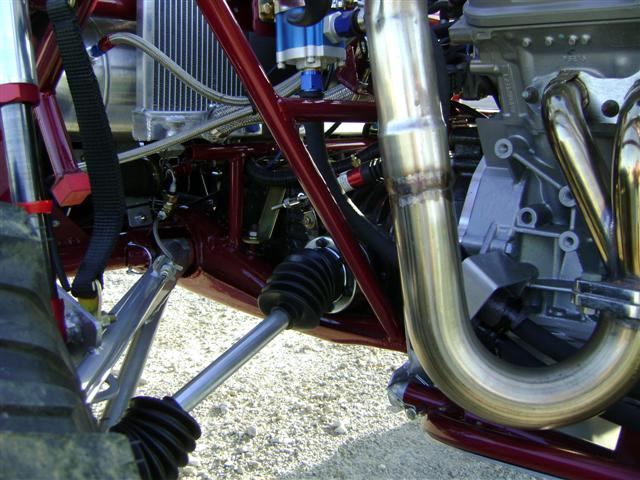

I have a 3.2 in mine with 091 trans. trans was built to handle the horsepower. Go to GOT HONDA in buggy builds

Hope these help give you some ideas for mounts and exhaust
