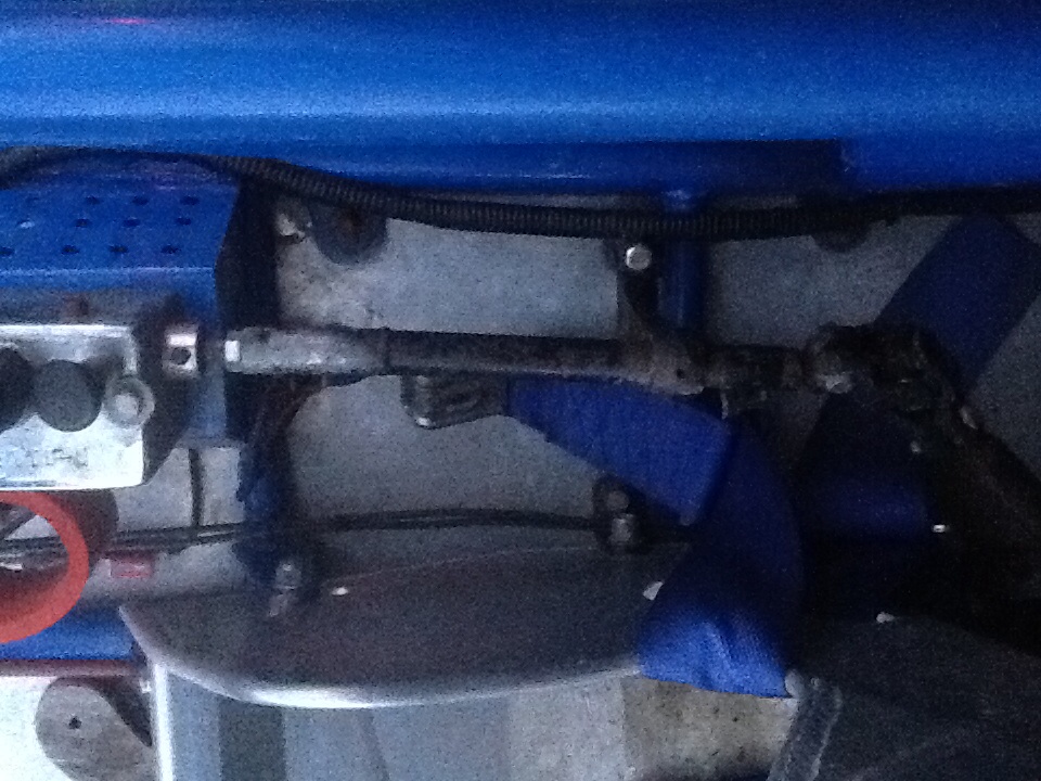

here is a pic of my race buggy.
here is a pic of kevins linkage.

having the bend before the joint lets the weight of the shift tube always hold the shifter to the 3rd-4th side of the shift gate. kevins has quite a bit more bend to it, but works great. You would never know it was bent like that if you didn't see it. My buggy shifts better than any buggy I have ever tried. It is just as tight as a new car.

they both have 2 joints. The red one has one on either side of the "s bend" and mine has one at the trans and after the first bend.

its one of those things that is way to easy to overthink. they are both regular old 6 ribs. Yes it is solid tube (heavy wall). Yes it does lift and drop with rotational movement.

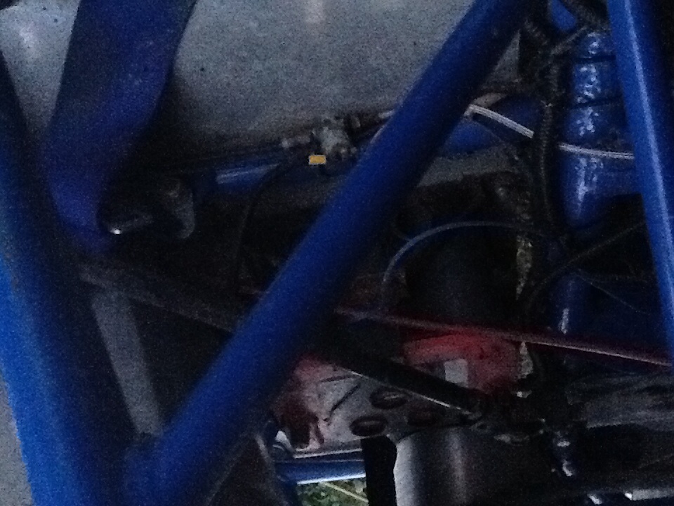

here is one joint connected to the trans
here is a pic from the other side. There is a small green bungee cord holding it down to help keep tension on it and keep play to one side.

Yep it works grate. The joints are from Drews off road they are a ball and pin and the one on the trans is 7/8 by 1/2 and goes wright on the trans . I welded a 1/4'' nut on it to go on the trans . And there is no ajusters to come lose. I hope to have the a arm buggy at Drews swap and sale April 12

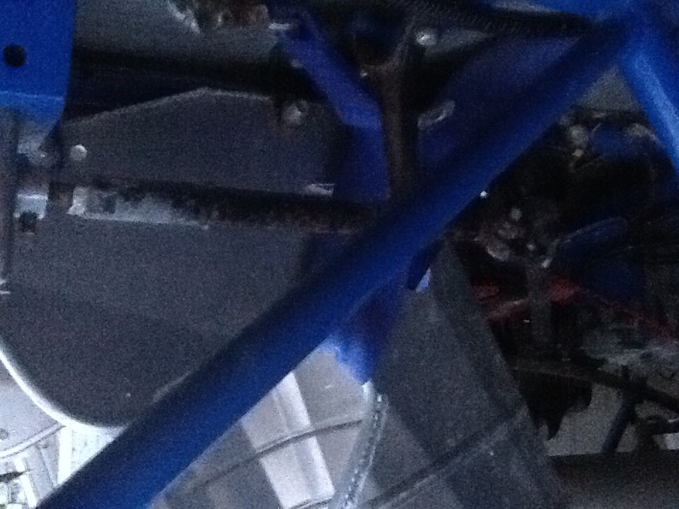

Two cheap ujoints and a used connecting rod. Works great. Chad :mrgreen:
