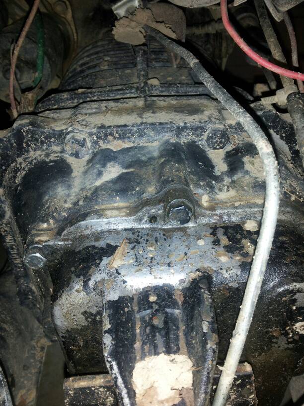

Last weekend I had oil coming out the top of the nose cone. Clean it up I have a hole beside the top bolt looks like it should be there what is it for
What do I need to do to keep it from pushing oil out?

I think it's just a vent. Mine pukes a lil bit every now n then

I always drill this hole a bit oversize and press in a small piece of tubing about an inch long and locktite it in. Then you can extend the vent up high using a piece of rubber hose. :idea: Every transaxle I build has this done to it.
