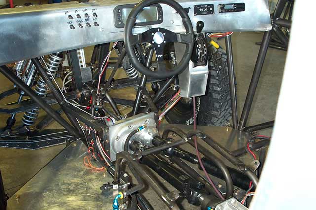

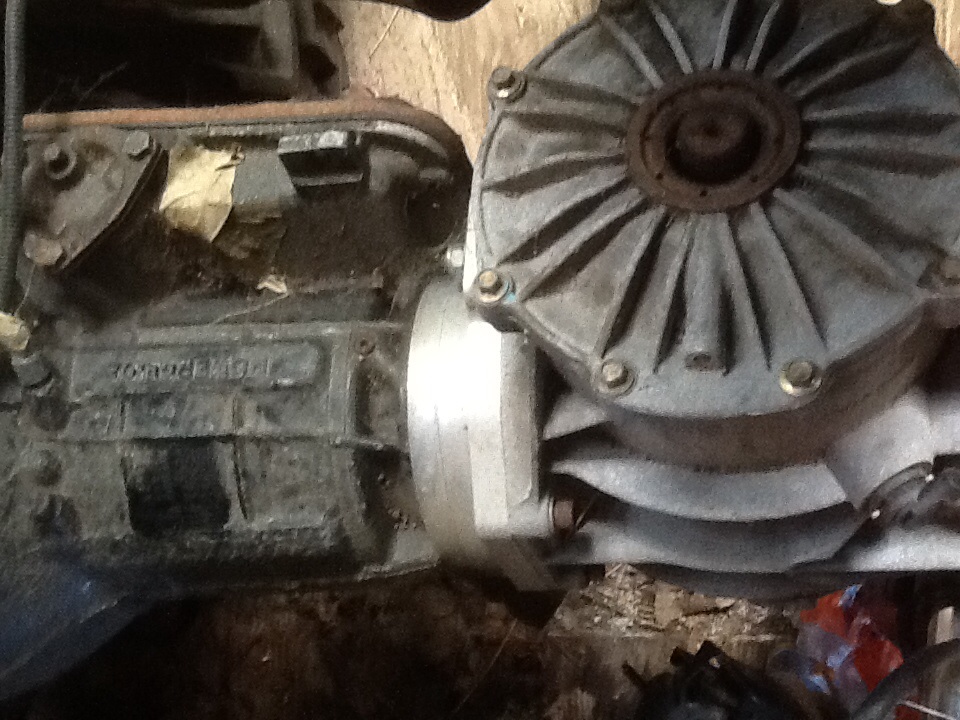

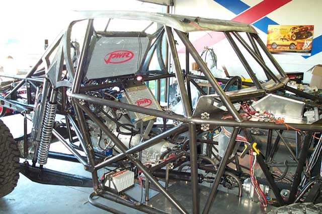

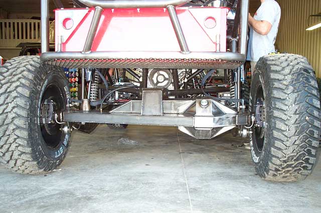

If you go the Colorado sand cars route you just need a v-drive and a couple custom drive shafts and that staggered rear end. Then pick a drivetrain and go...
By the time you've gone that far you may as well put the front diff in.

I couldn't agree more... That is why I haven't tried yet... ;)
