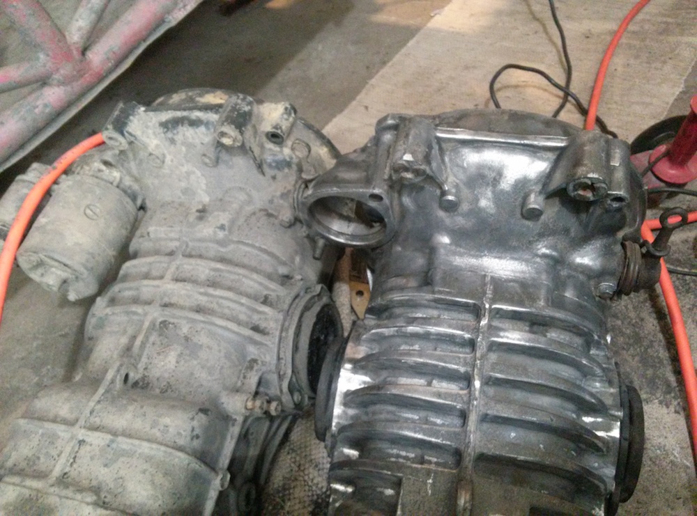

I am taking out the 3 rib and putting in the 6 rib. I also have an ALFA FAB 2.4 coming any day now.
I have a few Q?
-I noticed the 6 rib has tabs on the top, Correct me please but isn't that a 3 rib Bell Housing on the 6 rib?
---I ordered the adapter plate form AF to fit to a 6 rib, I measured the input shaft that sticks out past the bell housing and they are both 1", opening of the bell housing is 11" on both also.
Thanks for any input.

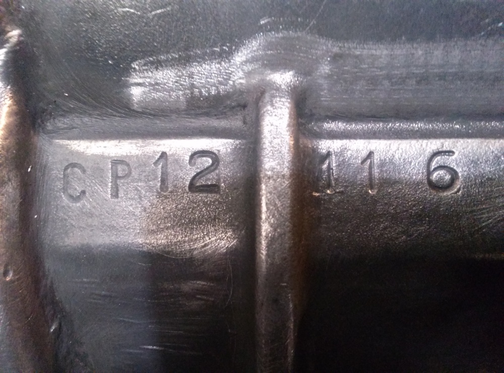

File comment: This was stamped on the bottom, can someone tell me what it means, there is a 6 after the #11?

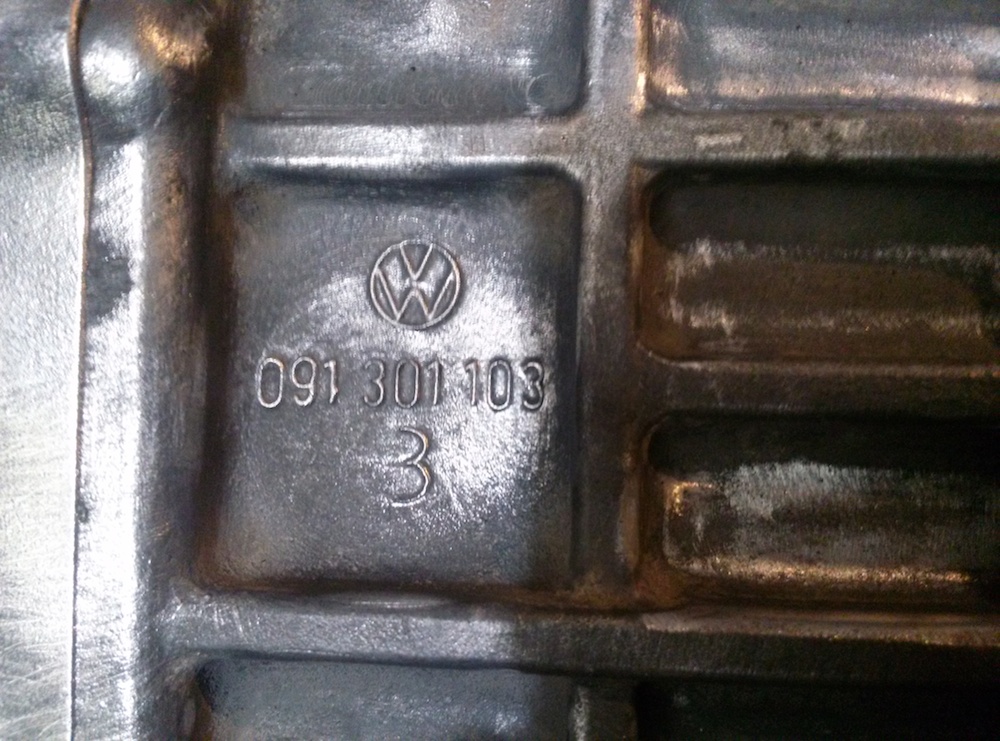

File comment: Here is the SER#

PostPosted: Tue Jan 28, 2014 12:54 pm
Not 100% but I think the 091 trans have the bell housing tabs on top. Every 6 rib I've had the tabs and 3 ribs didn't. I think 002 don't have tabs
PostPosted: Tue Jan 28, 2014 1:18 pm
My 3 rib has ears on top.

This should help you.
The 002...Aka the 3-rib
*Note: The earlier 3-ribs have no mounting ears on top of the bellhousing, axle flange retainers attached by acorn nuts, and a shorter input shaft (for the T1 engine). There's more info the early models provided by a member of TheSamba.com posted below the pic. They have a 5.38 (Also 5.42, but it is pretty rare) R&P ratio.
They are found in '68-'73 Buses
Transmissions for dummies http://www.shoptalkforums.com/viewtopic.php?t=102124
PostPosted: Tue Jan 28, 2014 1:37 pm
the last few years of 3 ribs had the tabs on top. those are the strongest of the 3 ribs. all 6 ribs have tabs on top. if your 3-rib has the prefix 113 in the front and an "A" at the end, those are the best 3-ribs and should have the tabs on the bellhousing.

Thanks guys,
I was sweating a bit, not sure why I was thinking 6 ribs don't have top ears..
-Can anybody tell me why there are stamped #'s on the bottom? Rebuilt at some time maybe?

PostPosted: Wed Jan 29, 2014 8:23 am
Thanks to everyone,
Still wondering about the stamped #s on the bottom?

PostPosted: Tue Feb 11, 2014 11:00 am
I like that first attachment you posted at the top — I've never seen a 002 & 091 next to each other, it looks like the CV output sits farther back on the 091? Having a 002 myself, Im very interested in anything you had to do to get the 091 to fit. New front mount? Need to modify the rear mount or did you use the ears?
PostPosted: Tue Feb 11, 2014 11:31 am
Unclejerm,
I redid my front mount because I did not want the 10deg tilt anymore, I built the first one so I just fabbed up the second, I used the standard strap for the rear but only used the lower section that bolts to the fram horns and lower trans mounts. If you look close at my build I also redid the bracing to the rear frame horns and put in a cross bar with tabs to mount to the trans upper mounts, I am also going to use the rear most stock engine mount for rear support, just above the pulley.
