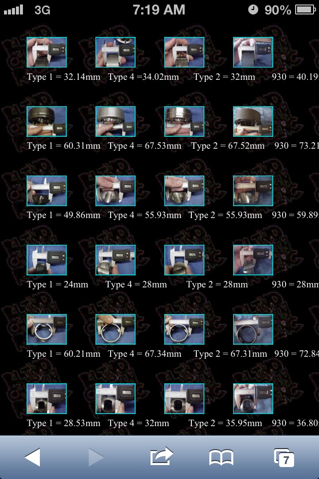

Yeah that's what I might do. I was reading an bug stars are 24mm thick an bus is 28mm so if I took 4mm off the bus star or the stop on the axle don't kno witch would be better it should work

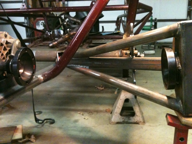

Yeah it's looking like I'm just Gona buy axles. I pulled motor an trany an got the 3 rib mocked up an the axles are Gona be to long.
How do you check for axle length. with both flanges strait across for each other ?
I realy thank you y'all for the help so far by the way.

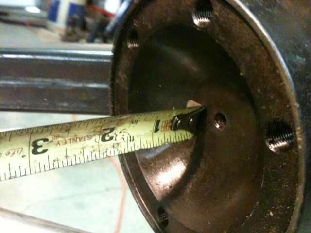

So I got every thang centered up last night an checked for axle length this morning. It's showing 18" at full droop an 17-1/2 with them at 0 degrees. Does that sound right ? It's all stock trailing arms an stuff why would it be that long ? Help would be nice about now lol.
I found some thing axles for 30 bucks a side but if I need a axle 17-1/4 they wouldn't work right.

i know you want to measure with the stub axles at same height. full droop of the arm might be to far for the cvs in some cases. can we get an axle expert to help this guy out

You want to measure it with them level to each other. Mine measured 17 1/4 minus a 1/4 equaled 17" axles.

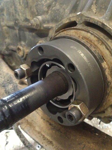

Yeah with them level to each other I got 17-1/2" take a 1/4 of that an il have a 17-1/4 axle. I took a stock bug axle and turned the c clip grove out some so I could get a clip on the trany side with a bus cv an it looks a little long to me but I'm Gona run it an see what happens. Hears a pic with the axle pushed all the way to the wheel side.

If you have axle and cv's installed, level it all up and as long as the axle doesn't bind and you have some side to side play you should be good...

Yeah I under stand that. An I have around an 1" on movement with them at 0 degrease. An have about 1/2 at full droop.
I'm going to put it together like that an see how it dose. Then save up for a set of axles.

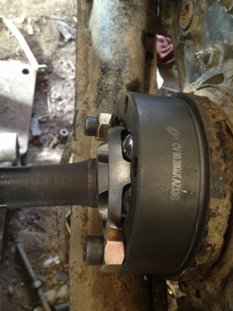

Here's a pick at full droop
