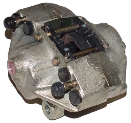

I have a set of disc brakes for my sons rail and not sure what they are. They are a single piston full floating brakes and they have a VW II stamped on them.I need a rebuild kit for one but not sure what they came off of. Anyone?

Look like this one Mike?
Gary

dose it look like any on this page http://www.dansperformanceparts.com/bug ... ytcbh1.htm

or these not the best pic http://www.cbperformance.com/catalog.asp?ProductID=1172

jesse wrote:
They are real close to the 01-22-6125-b.Mine don't have a hole in the top.Do those come stock on any vw? I need a rebuild kit just for the rubber garments on the long bolt that the caliper slides on.

from what i can find, the vw II caliper was used on late 80's golf, gti, cab, etc (239mm. disc). you might get away with going to an import auto store and taking the caliper with you.

I was told it could be off of Scirroco or Rabbit. I'll try to match it up to one of those.
