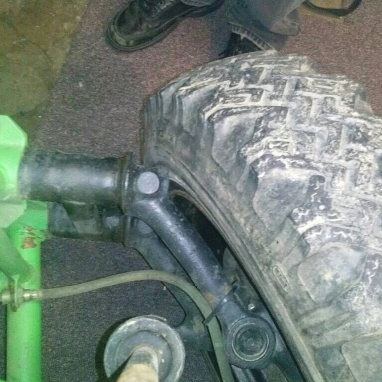

looking for some ideas for a steering stop for ball joint. I thought my only problem was the tire hitting my frame and rubbing the paint off but after closer inspection my problem is much worse. at full turn my tire is rubbing the control arm and wearing a groove in the side wall of the tire. been pondering this for a week now and the only idea I got is modifying the steering stabilizer. my idea is to move the mount on the beam to limit the steering at full extension of the stabilizer then welding a nut on the stabilizer rod to limit the steering in the other direction. my only concern with this is killing my stabilizer and possibly pulling it apart. any thoughts on this? any better ideas?

How is it possible you tire is rubbing your control arm? frame yes but control arm, can you post a picture?

dave im not sure i understand what your saying. my alignment is right i did it with a machine at work. the problem is my tires rubbing at full turn both ways. rick i know it sounds crazy but my tire is rubbing the control arm where it pivots on the torsion. ill get a pic when i get home tonight and post it.

I could see on a wider beam that could happen, but my tires hit my frame before they get that close.

Wrong offset wheels?
 Post subject: Re: steering stop ideas?
PostPosted: Fri Jan 10, 2014 9:40 pm
hmmm? yeh a different off set wheel would fix it. do you have stock vw wheels on the front?

Flip your rims inside out and no steering stop needed :)

run smaller tires. Do NOT flip your wheels inside out unless you don't value your fingers or wrists anymore.

last thing I want to do is run smaller tires. these are only 6.00-15. I agree with saving my fingers which is why im still debating getting the spacers off mike.

Even a 1/2" spacer is going to cause some very minor steering changes and are not the perfect fix. The best fix would be to change the offset in the wheel. Just how wide are the floor rails on your car hp ?
